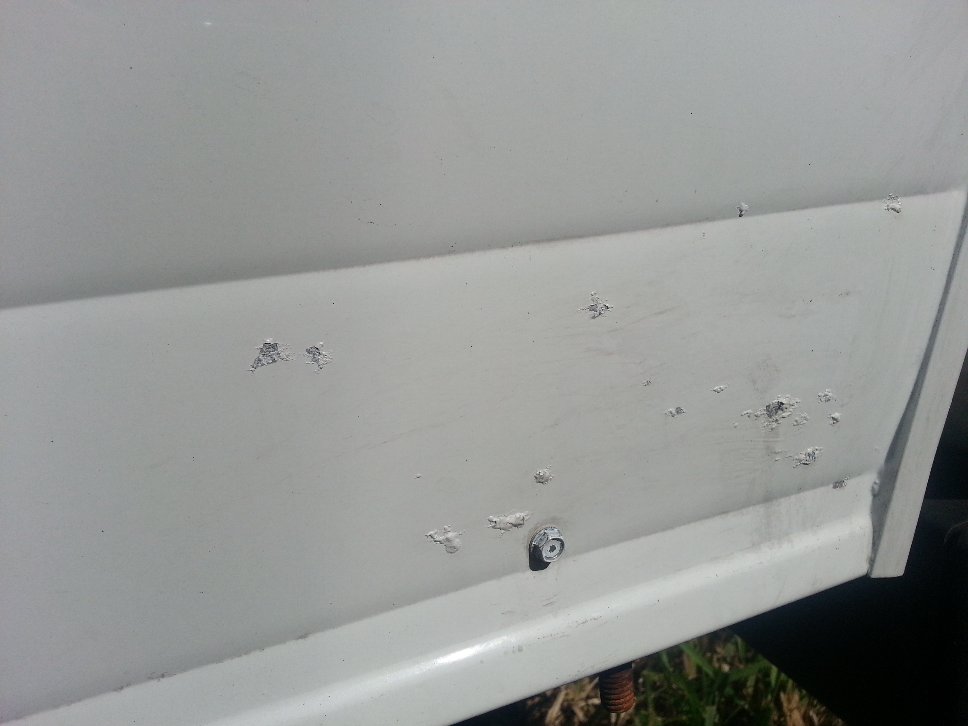

Ok finally got my KZ back 1 week 4 days without her..a thermostat was out in the frig..$210 not counting labor..total $398.67..frig now got to 40 in the frig area and below 0 in the freezer..They also did some mateniance  on the side of my trailer got a water leak and looks like my trailer is rusting or has acne. Dealers says its the water in the wood,not rust . scroll over to the right to see it above bolt…….So I'm good to go.     Laugh
