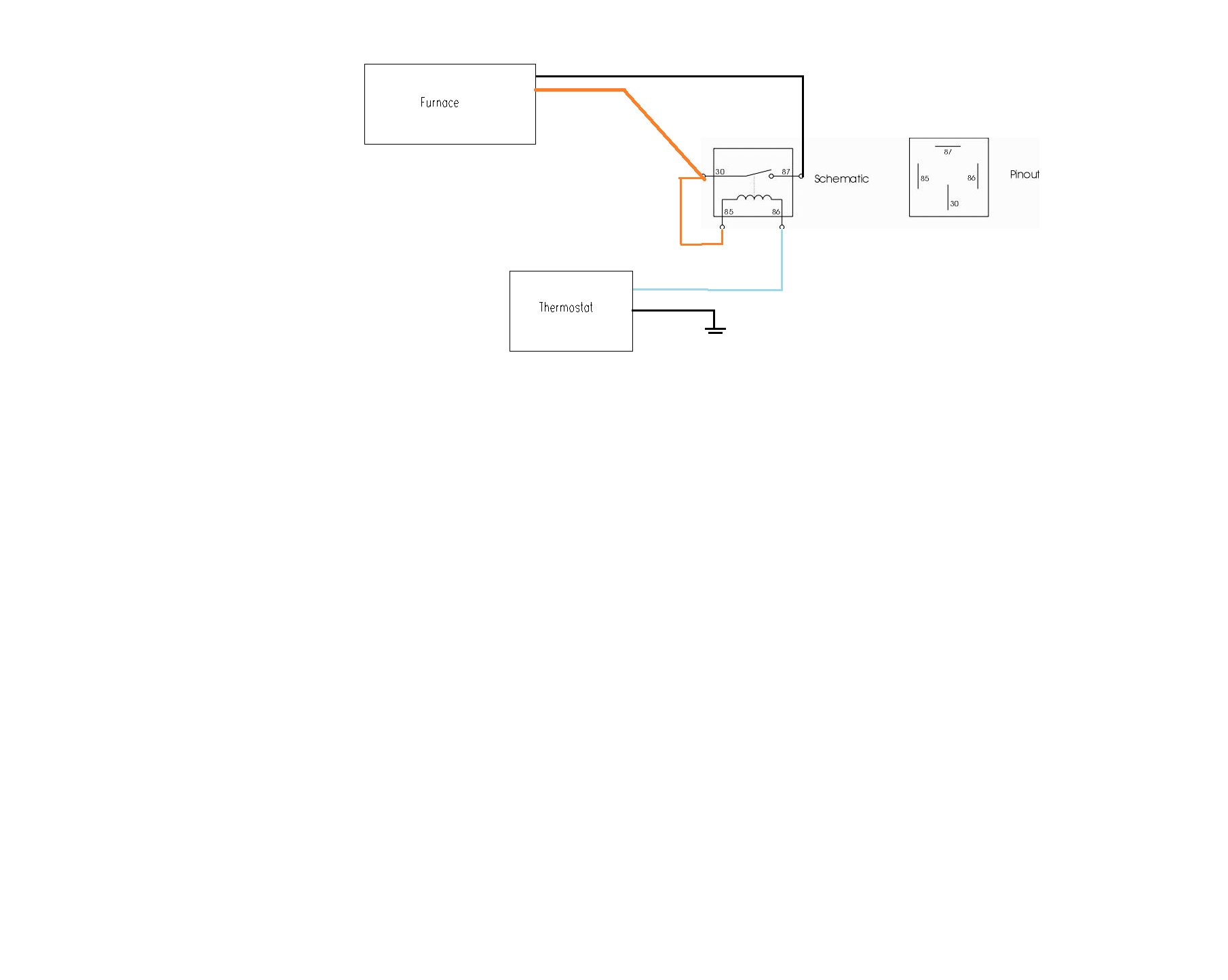

I just recalled the digital thermostat closed the ground circuit on the control side of the relay. It did not actualy power up the relay with the 3vdc. I could provide a simple drawing if anyone is interested.

If tyou're referring to the thermostat's internal switching relay, that makes sense. Relays generally have a coil voltage rating – ie: the voltage needed to energize the coil side of the relay to either open/close the NO or NC contacts, in my field of work, most relays have a coil voltage of 24VAC – sometimes they will close with less voltage, but can weld the coil.

This is how I wired in a standard bosch type relay.

Makes perfect sense now – you're simply switching ground open and closed. Most thermostat setups normally switch a power source, not ground. But that will work – so long as the thermostat side doesn't rub through or short to ground – then the furnace will stay running! That's good – I wouldn't have even thought to switch the ground leg of the coil.
