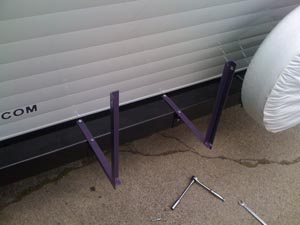

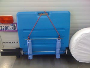

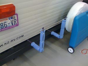

8:18 pm July 5, 2010
Hi sportsmen,
I made a rack for my waste tank. I used angle stock for the horizontal and vertical portions and flat bar to make the u straps that go around the bumper. I cut the vertical portion angle stock where it goes over the bumpr and bent it over, that rests against the bumper to keep things horizontal. I welded the uprights but they could be bolted together.
I hope this is useful.
Chuck

Thanks for the pics Chuck, that looks fairly easy. We got a 30 gal Barker tote from my
