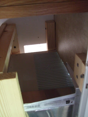

Matt is right – looks like it's going to be the 6500 once we got the old one out – which was a definite chore. The A/C sits on a piece of sheet aluminum that is folded up on the sides to make a sort of drip pan. The front of the aluminum was siliconed to the back of the cabinet rail.
The only way to get the A/C out was to dismantle the cabinet. And the cabinet is not screwed together – oh no, nothing that simple. The bottom is 1/8″ luan that was stapled to the cabinet. Removed that – no screws holding the cabinet face on – oh geez, how is it held together? Turns out it has the wood staples that look like a cross between a staple and a biscuit holding the stiles. We were able to bang them out from inside the cabinet right next to the A/C – remember we have the bottom off at this point. Then pulled the bottom rail off – when we found the silicone.
The hole is framed out with what looks like maybe 2×3's. Tomorrow's job will be to see if it's just framing or if the verticals are actually jack studs above the window. If it's just framing we are in good shape and will only have to widen the hole less than 2″. If they are studs, we will have to think it through a little more.
One thing I still haven't figured out is what we are going to do about the outside shroud. The top vent is no issue, it's plenty wide enough. But the side wall shroud pretty well just fit around the 5K unit. Oh and they added an extra piece of expanded metal on the back of the A/C for protection – we will have to get some more cut. We are talking about getting some aluminum stock and building a frame around the back of the A/C. The plastic shroud was held on with about 18 hex head screws with butyl rubber tape as a gasket, then the edges caulked. As long as we can protect the hole and the edge of the A/C while allowing for drainage (holes in the bottom), we should be good to go.

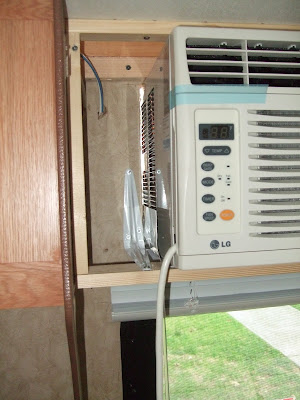

Progress has been slow because I'm finishing up a term in school – going to graduate school and have only had an hour here and there to work on the trailer. We've got the framework pretty well figured out and have test-fit the A/C – we had to do some modifications on the hole in the side of the trailer.

I like! Can't wait to see the pics of the other side.

Once we get the water going where it's supposed to go (outside not inside), we will be working on the outside frame using aluminum stock and expanded metal mesh to protect the outside fins.
And of course, tonight as I'm sitting in the trailer with the A/C on waiting for it to generate water so I can see where it's leaking – no leaks! But since I did have water last night, I'm not trusting it.
