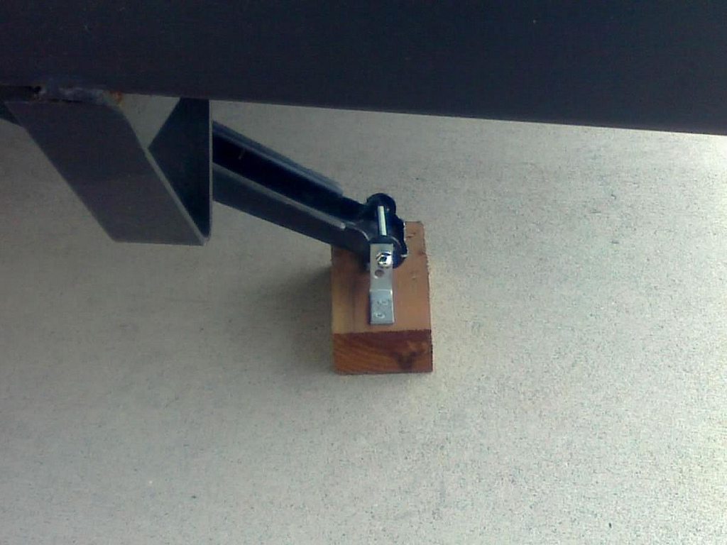

I picked up my KZ Sportsmen Classic 16FKTH and have it parked in my driveway. When I was spinning down the factory installed stabilizer jacks I noticed they don't have a flat base or foot on them. Has anyone found a foot or pad to add to these? There are holes on the side that look like a aftermarket foot pad could be added. I'm on conrete now and it is not an issue, but I plan on camping in some rural areas that may have dirt pads and i don't want the feet sinking into the ground and feel a foot pad would help create a more stable base.

I made my own out of some scrap ripped treated 2×6 attached with some L-brackets. The first set of brackets I bought ended up being too light and twisted, but the beefier ones I got after that seem to be holding up just fine. I thought about buying the fabricated ones from BAL as well, but…I can't see it's worth the expense. Picture is below. They've since been painted black to match everything.
