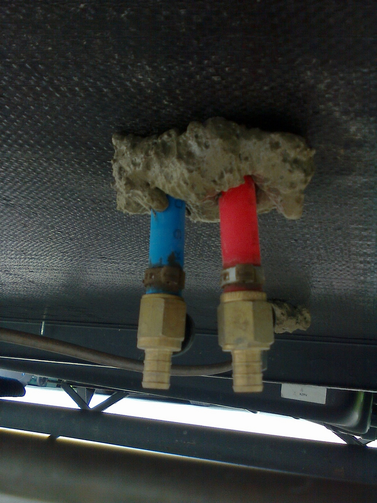

I don't have any plumbing under my 16bh (as far as I can see) except for waste. I have one drain valve and it is under the dinette seat with a drain tube going through the floor. Looking at the plumbing under the seat it does appear that blue is for cold and red for hot. The valve on your TT with the red tubing could drain the hot water tank but if your tank is plumbed like mine the red tube (oulet) is on the top of the tank and would not drain. Can you follow the tubing on your TT after it enters the inside?

Our 16BH has the drain on the tank itself and a red and blue drain just about under the sink on the underside of the trailer. these drains WILL NOT drain the hot water tank. You must remove the anode to do this, which can become a pain in the rump. I saw in an RV catalog that someone, I cant remember who, makes an anode with an intrigal drain valve. It seemed a little pricey but it could be worth it just for the ease of operation. I will look and see if I can find the manufacturer and post it up. We have found that the taste of the water in our tank is somewhat lousey even after sanitizing the system. I work for a major water utility so I know about treating water and it still always tastes like plastic. Using the hose for city / campground hook-up isnt much better. We ususlly bring water from home in bottles for drinking and cooking and use the tank water for washing and brushing teeth etc only. Anyone else experience this taste issue? I wqs going to install a Stainless tank to help resolve the issue. Mike.

So last night I looked at my system again. Here's the drain lines under the trailer, located on the street (port) side halfway between the front of the trailer and the axle. This is in addition to the fresh water drain accessed from inside.
Since the red (hot) line comes from the top of the water heater, and the blue (cold) line comes from the bottom, I'd think that if both valves were opened, it would drain the hot water tank and the lines?? I need to test that theory to see if it's true. The fresh water tank would have still have to be drained with its own drain under the street-side dinette seat (I hate how hard it is to get to that thing!).
Apparently not all of the trailers are plumbed this way, however.
