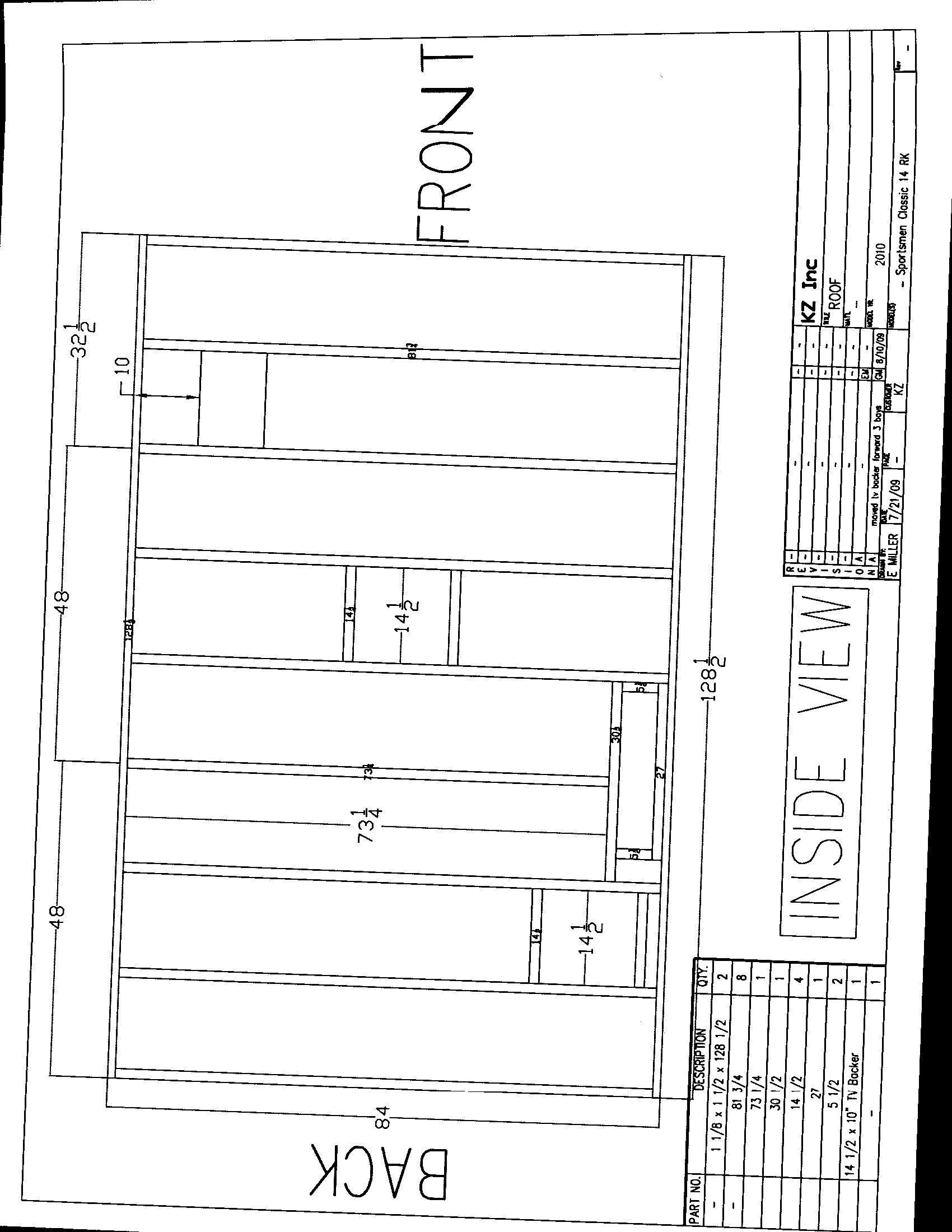

I need a schematic of the supports under the aluminum roof in order to mount my solar panel to my 2010 14RK. I don't know where to screw it down.
This could be the same info you would need to repair a puncture in the aluminum skin.

John and Suzy, I'd contact KZ-RV Customer Service direct at 1-866-472-5460 to obtain a schematic from Engineering dept. Perhaps, you could locate roof joices with use of electronic stud-finder……granted you risk screwing into hidden wiring, causing an electrical short.

K-Z has sent the roof drawing with the caveat that puncturing the roof would void the one-year warranty.
