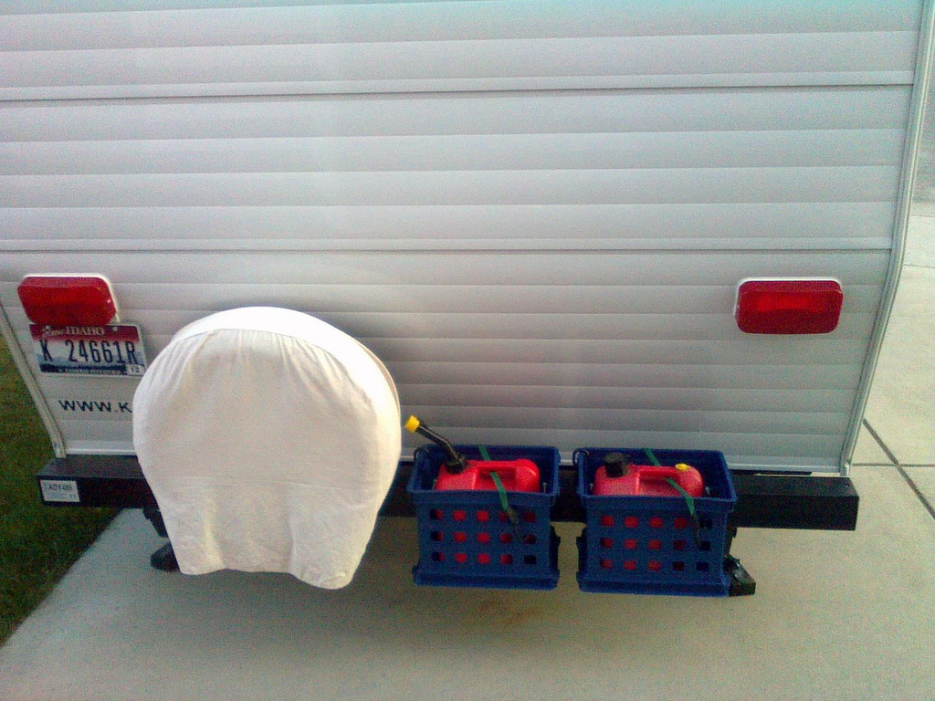

So…this may not be a very popular addition, but here's my results in case it might be helpful for someone. After searching for many different options, I happened to find a plastic storage bin that fits 2-gallon gas containers perfectly and securely here. I mounted two of the containers, each using two 4″ U-bolts from the hardware store, and moved the spare tire over. I drilled a few holes in the bottom for drainage. Weight added to the back bumper is around 25#, with fuel.
Happy camping!

My local parts store carries a u-bolt mounted reciever for a small hitch. It specifically stated that it is to be used for a cargo carrier and
not a ball mount for another trailer. But all this takes away from your remaining weight capacity. I like your rig and dont see any problems with it myself.
