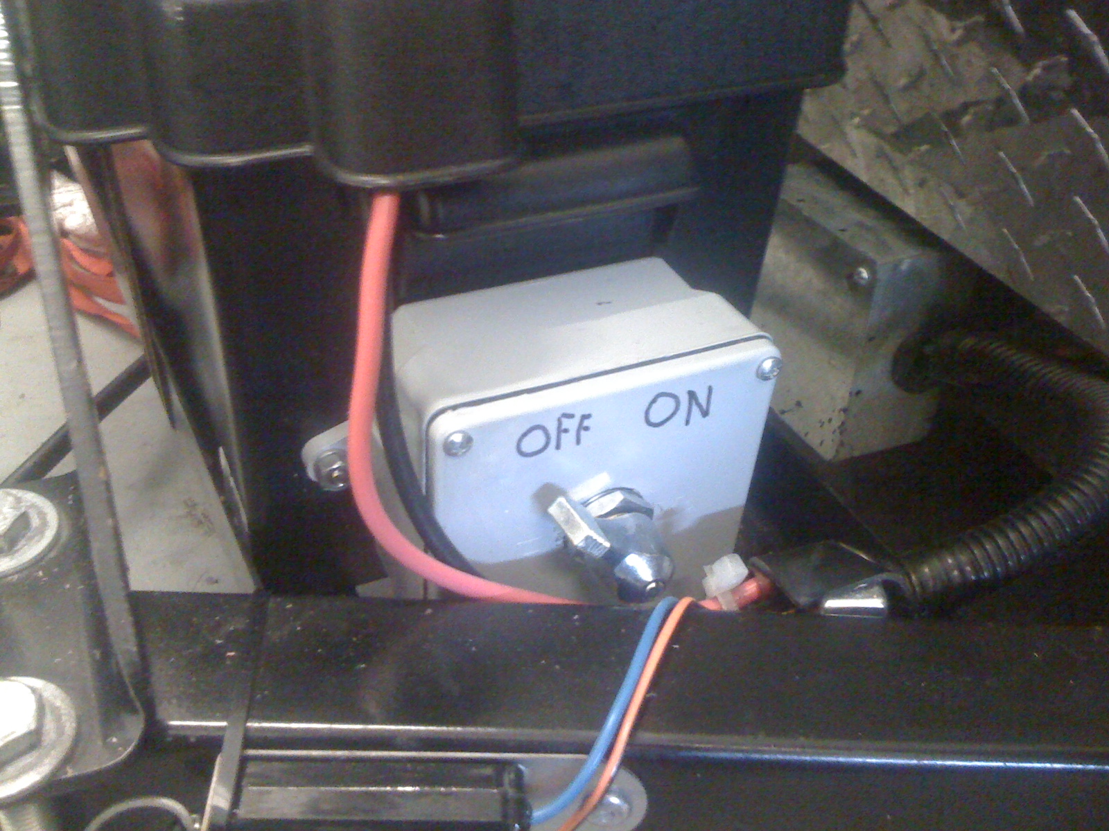

Probably a bit overkill but I wanted to disconnect my battery without lifting the cover and without a key to lose. I used a Cantex waterproof box #5133705 and a Cole Hersee switch #3484-BX. The switch terminals protrude into the battery box slightly so I put a piece of wood between the battery and battery box to prevent the terminal lugs from damaging the battery. I used rubber weather strip to seal the switch box to the battery box.

This is exactly like a job I asked my dealer to perform – ability to unhook the battery with the flip of a switch. They looked at me like I was crazy.
Nice job. Cool looking as well.

Thanks mbanda………..I thiink I feel my head swelling . I would be happy to give more specifics if you or anyone else wants to do the mod.

You're both crazy! Just kidding. Nice looking mod.
You have to remember to flip the switch to "on" or the battery won't charge, am I right? See, I would forget. I'm probably better off without something like that.
9:41 pm April 2, 2011
You are correct. I hope I don't forget……like the time I forgot to unplug and stow the shore power cord… ooops.
