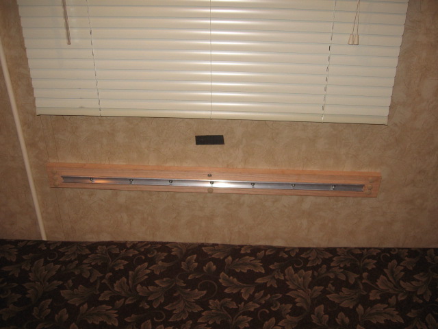

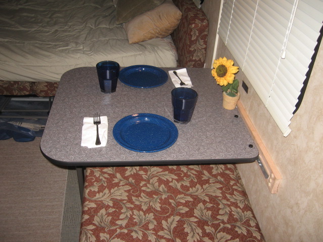

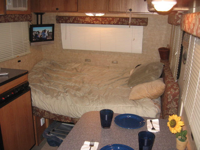

 Hello all…Here are the most recent mods completed on my 14RB…First is the addition of a dinette table over the couch. (Wonderful idea posted by Julie) I chose to mount the table with a slide bracket instead of the hinge system. Allows me to slide table down to make room for the dog or simply lift it up and remove it to store somewhere else. Cost approx. $150

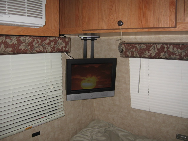

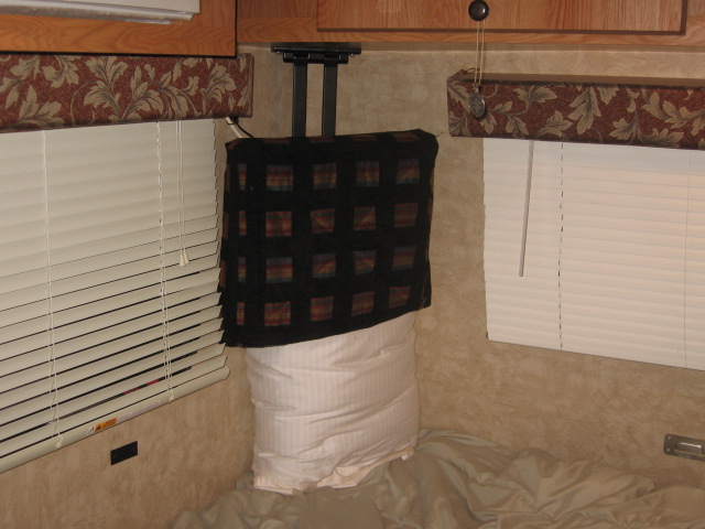

 Table                                               Wall bracket mounted on oak Here's the TV. It used to take up space on the counter top. I purchased a wall mount bracket but ended up mounting it under the overhead bed cabinet. I have a custom made cover and use a bed pillow to cushion it for travel. I tucked the cable and power cord under the window valance. Cost under $20.

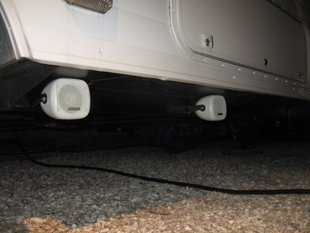

           Ready for travel! The outdoor speakers were purchased at a marine store. Waterproof etc. Mounted to the frame and fit really nice. Sounds good too. I ran the speaker wire from inside cabinet, down wall and thru floor. Cost approx. $50

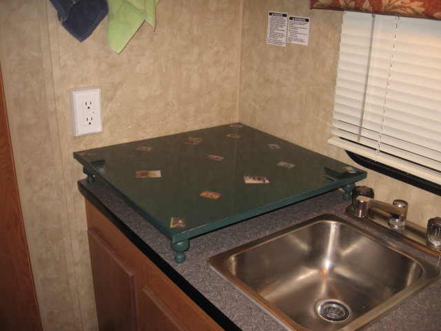

 Speakers underneath                              Wire hiding piece Here's an over the stove table I made for more storage when not cooking. I made this and put stickers of moose, bear and elk on the top then poured that clear epoxy stuff on it.

where did you get the tv mount? |  |
| | 9:26 amAugust 13, 2011
 |  | Cat
 |  |  |  | South Florida |  |  |  |  |  | Member |  | posts 27 |
osage said:where did you get the tv mount?
 Got the TV mount on Ebay for $16.00 included shipping. |  |

Hi Cat,  I purchased some outdoor/marine speakers, have you had any issues traveling w/ the speakers mounted to the frame like that?  Do they loosen up at all from the vibration while towing? |  |

I've got a pair on my 16bh I use RCA plugs to connect them and take em off during travel |  |

 Hi Mike, I mounted the speaker brackets with bolts thru the frame w/ S.S. hardware and used those type of nuts w/ the nylon at the end so they cannot vibrate off. Also replaced the little screws that came w/ the speakers to mount them to the bracket w/ S.S. ones, and then put a dap of silicone caulk over the ends to avoid vibrating off as well. I've used it alot since the install even been thru rain etc. and haven't had any problems. Mounting is still good and solid.  |  |

Look like some cool mods.  Did you cut down your dinette table or build from scratch? |  |

 LOVE your tv modification. I use the top of the frig but wanted to move it..what kind
 of extra re-inforcing did you do inside the cabinet. How bouncy is the tv? size of TV too? Any advise would sure be appreciated. Also a Fla KZ-er (Miami area) here's my baby  http://www.flickr.com/photos/h…..791126879/..

Hello Homebody, The TV is about a 13″ and I reenforced the inside bottom of the top cabinet with a small piece of plywood cut into a triangle shape to fit in the corner and drilled the mounting holes through the whole piece. The TV is extremely sturdy and does not wobble at all. But because it is mounted on a hinge I put a pillow behind it  just to keep it from possibly swinging into the wall during travel. The mount is a standard swing style arm for the wall. I just turned it vertical. I have not added any speakers for the TV. |  |
